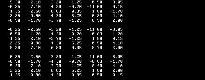

Да знаете - я уж как-то по-своему. Если устроит:
Код:
Uses CRT;
Const
 M=5;
 N=6;
Type
 Matr=Array[1..M,1..N] of Real;
 Vect=Array[1..M] of Real;
Const
 A:Matr=(( 5.30,  2.10, -3.20, -1.25,  0.50, -3.05),
         (-0.25,  7.10,  4.30, -0.70,-11.00,  0.15),
         ( 1.35, -2.50,  6.83,  0.35,  1.80, -1.70),
         ( 2.25,  0.90, -4.30,  5.25, -0.83,  4.10),
         (-0.50, -1.70, -3.70, -1.25,  8.90,  2.00));
Procedure Razd(var R:Vect; var Nr:Byte);
var
 k,l,p:byte;
 d:real;
 bu:boolean;
begin
 p:=1;
 for k:=1 to M do
  begin
   if R[k]<0 then Inc(p)
   else
    begin
     bu:=false;
     l:=k;
     repeat
      Inc(l);
      if l<=M then
       if R[l]<0 then
        begin
         d:=R[k];
         R[k]:=R[l];
         R[l]:=d;
         Inc(p);
         bu:=true;
        end;
     until bu or (l>=M);
    end;
  end;
 Nr:=p;
end;
Procedure Upor(g:byte; var U:vect);
var
 p,q:Byte;
 d:Real;
begin
 for p:=g to M-1 do
  for q:=g to M-p+g-1 do
   if U[q]<U[q+1] then
    begin
     d:=U[q];
     U[q]:=U[q+1];
     U[q+1]:=d;
    end;
end;
Procedure Output(T:Matr);
var p,q:Byte;
begin
 for p:=1 to M do
  begin
   for q:=1 to N do
    write(T[p,q]:8:2);
   writeln;
  end;
 writeln;
end;
Var
 B:Matr;
 V:Vect;
 i,j:Byte;
 Nom:Array[1..N] of Byte;
Begin
 ClrScr;
 B:=A;
 Output(B);
 for j:=1 to N do
  begin
   for i:=1 to M do V[i]:=B[i,j];
   Razd(V,Nom[j]);
   for i:=1 to M do B[i,j]:=V[i];
  end;
 Output(B);
 for j:=1 to N do
  begin
   Upor(Nom[j],V);
  end;
 Output(B);
 ReadKey
End.
    24.5 KB · Просмотры: 69
