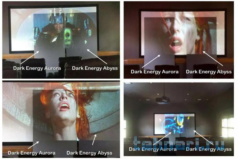

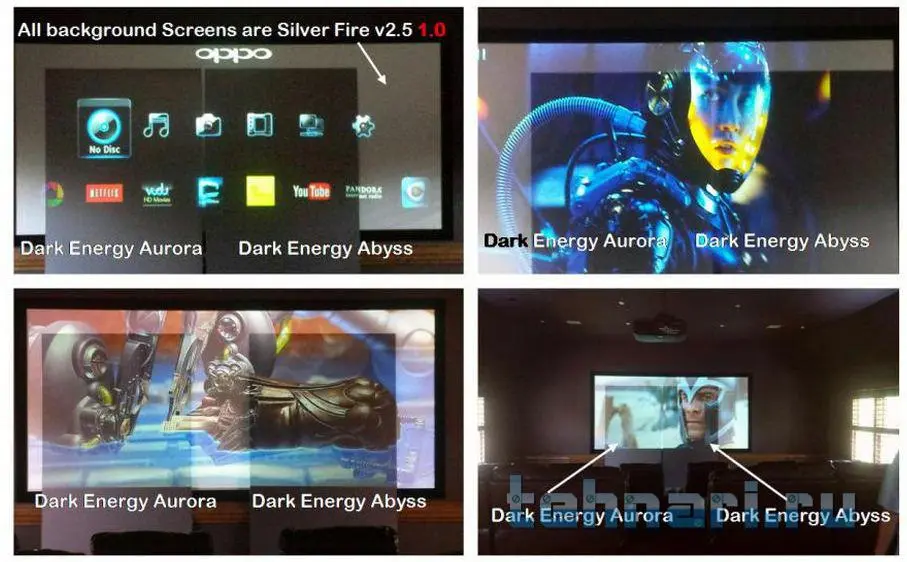

OK.....everyone seems to be having so much fun I decided to toss my own hat into the ring. Somewhat.
For some while I have been somewhat less than totally enthusiastic (...but interested and supportive...) about these wet laminated "Black Screens" for several reasons.
Cost and availability of materials
Substrate limitations
Consistency in the wet laminate application
Size size Limitations
Reduced Gain requiring higher Lumen PJs
Too much attenuation of Whites and Colors
Color pushes
Supposed durability issues
Viewing Cone issues.
Reduced performance under extreme conditions
Overstated Claims, understated issues
The last couple examples I have seen come out of this Thread have raised the Bar, most noticeably J Bone's, but still much of the aforementioned still needs to be addressed.
So after having consulted and collaborated with another erstwhile DIY wizard for the last 45 days (btw, this is primarily his child...) , the end result is this:
A true "Hot Laminated Screen that has at least 3 separate levels of available Darkness, and varied levels of performance
"Current" Maximum individual Size availability (Diagonal) 122" @ 16:9 to 155"@ 2.39:1 Of course their is no minimum size limit nor restrained choices of sizing
Consistent gain of 1.0 - 1.2
NO color pushes
Minimal attenuation across the visible light spectrum
High Durability...easily cleaned
Wide range of installation potential. Solid substrate (water proof / never warp), Flexible Fabric, Semi Rigid Material w/Self Adhesive backing, and Electric Retractable Screens
Perfect "Zero Edge" build so precisely Tiling screens to achieve any size is easily done
Extreme Performance under the worst scenarios
Actually affordability for the common man.
The material being used is not Car Wrap, nor shaded Vinyl, but actual Optical Diffuser material specifically suited for the application intended. The material is applied to the various substrates via a true laminating process that assures precise quality control
Now to head off any controversy, this post is more the nature of a reveal, but it should be clearly noted that there will be made available versions of the above that will be specifically intended for the DIY'er, and very soon there will be a call for Beta testers...not so much to confirm viability of concept but rather to confirm actual performance and quality of build. The Finished Fixed screen versions on Solid substrates will of course find their place among all the rest of the similar Mfg "Black Screens" and dwell on the "Screen's Forum". But the flexible Cloth version that can be stretched onto a DIY Frame, or the semi Flexible version that can be applied directly onto a smooth wall or virtually any such surface...those are intended to fill the needs of DIY'ers that really REALLY need the highest level of ambient light performance and for whom spray painting advanced coatings is not an option.

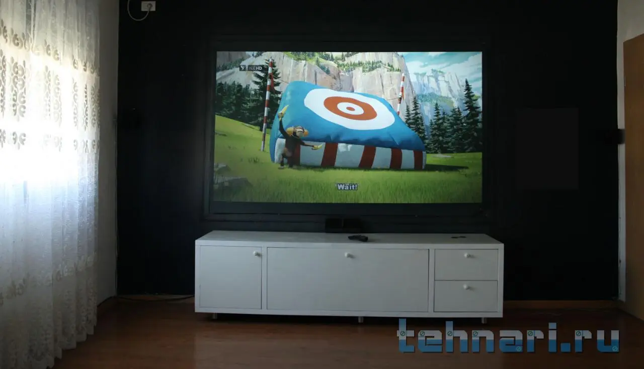

In the layout below, there are two different versions (48" x 85") set against a 143"diagonal 2.39:1 Silver Fire v2.5 1.0 screen. The projector is a Panasonic AE 8000u set at 16.5' with NO preferential calibration done...straight up Normal Lamp / Standard Image setting. Not wanting to bother with mere incandescent lighting, the images shown are taken with unrestrained Sunlight falling directly across the Screen wall...coming from no fewer than 6 Double Hung widows, 3 on each side of the room. The room is painted to be non-reflective...the only real "advantage" in the entire scenario.
I have already hung some handles on the two versions....appropriate ones I feel. Dark Energy "Aurora & Abyss"*
*all rights reserved
I am waiting for samples of both the DNP Super Nova and Black Diamond .8 / 1.4 screens to arrive so as to make some detailed comparisons. Having seen both, I'm expecting to see a decided improvement across the board...crazy less cost differences notwithstanding.
Again, please note that part of the above is not intended to be a DIY application, while part will indeed fall under that dictate. No hidden agenda here...it is what it is. For all those on here striving to create a totally sharable application, get'ter dun! Some great strides have been made. Providing options is what DIY'ism is based upon. These days, with the lines having become less drawn and the need to embrace select products that help DIY'ers realize real value and performance, having all the options presented can only be to everyone's advantage.
I'm proud to have been allowed to put this out for everyone to see, and have it be first seen on the DIY Screen Forum. Please keep discussion limited to opinions as relates to viewed performance, as relates to whatever other Black Screen application examples are called for.. This is not currently a product for sale, so don't ask about pricing or availability. When all that does come about, it will do so in the proper manner, (...including some beta reviews...) in the proper venue and be presented by a Forum Based Advertiser / Sponsor. Then those who desire to can either feast...or gnaw away.

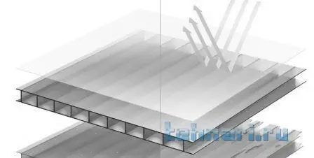

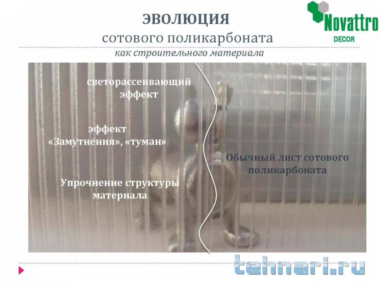

Задумал опробывать такой вариант -сотовый поликарбонат как лист жесткости с ссади темный материал(ткань темная или краска..) C лицевой стороны наносится либо полупрозрачная смесь ,либо матовая пленка..Задумка в сотовой структуре листа,внутренние ребра жесткости создадут световой барьер и темная сторона не должна засвечиваться(свет будет рассеиваться и яркость его будет ослаблена)
Само же изображение отражается от полупрозрачного Матового слоя..

На фото с сайта AVS парни не раскрывают секрет материала ..Но это листовой многослойный материал препятствующий засветке именно темного слоя..

Вот представлен материал с эффектом жалюзи...Что то типо этого хочу получить от сотового карбоната,его структура из ячеек поможет в этом..

Я ошибочно принял led панель за экран,это из другой оперы но такой эффект нужен для чёрного слоя,распространенный вариант сотового карбоната это внутренние полосы ..либо нужен тёмно серый полупрозрачный либо красить прозрачный карбонат..Но таким способом может получиться очень интересный тёмный слой(свет с боков будет блокирован) и чёрный остаётся максимально тёмным ,в наших экранах происходит засветка и тёмного и верхнего слоя одновременно(это минус схемы) ...Если мы представим экран из слоёв где тёмный не будет засвечиваться а верхний слой полупрозрачен и отражает картинку(засветка верхнего слоя менее заметна в отличии от засветки чёрного слоя) то получим концепт другого по свойствам экрана..Какие будут мнения?
Если картинка будет отражаться от двух слоёв,то даже под небольшим углом проекция будет двоится.пробовал с прозрачной тюлью,нанягивал перед экраном.расстояние между ними было около 5 мм.что то похоже на 3 d.
WSCC от темного(черного) слоя из поликарбоната отражаться не будет...Именно такая обьемная конструкция со своими внутренними перемычками создаст эффект тени ..А верхний отражающий полупрозрачный слой напыляем на лицевой стороне..Задняя стенка закрашивается черным...Вопрос видны ли будут эти перемычки под отражающим слоем? А то полосатая картинка нам не нужно..Вообще высматриваю темно серый поликарбонат(полупрозрачный)Но заднюю часть экрана черным закрасить все равно придется..Или шаманить над прозрачным вариантом..В магазине именно прозрачного много...(пока только мысли)..Но какой то будет результат.

И почему вы думаете что от чёрного слоя отражаться не будет,я думаю что бы не было отражения нужно покрасить внутри,а иначе между чёрным слоем и светом от проекции будет слой поликарбоната и на нём будет второе отражение.поправте если я что то не так понял.
Отражает любой цвет(вопрос в потере яркости ..) А чтобы тёмный не бликовал сделаем матовым для максимально возможного затемнения рассеянного света(сторонний источник освещения)..Мои поиски именно потому что все наши конструкции по сути одинаковы(тёмный слой и светлый одинаково засвечиваются..)Вот и размышляю как обойти засветку тёмного слоя,я думаю это сильно повлияет на контраст в целом ..?
Заметим что при просмотре на белом полотне и включенном светильнике больше всего теряет именно чёрный цвет в картинке(по идее его и нужно оградить от засветки..(Ну сам экран будет конечно серым казаться но работать несколько иначе..)
